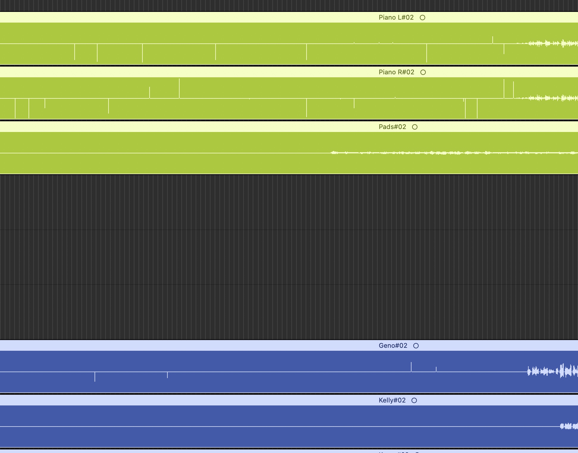

So, when all is said and done, we still can get Dante OUT of the GLD but not INTO the GLD. And now the Dante out going to Logic is giving us corrupted files.

That’s a clocking issue. If the clocking is broken, it could affect the complete system.2023/02/14 at 9:08 am #111507Which sample rate is your Logic using?

Does your system/recording still have clicks?2023/02/14 at 3:04 pm #111516Remove the AVIO from the network. Clicking will likely go away, and you might even be able to get Dante audio into the console.
